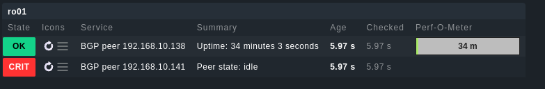

Than i created a rule for the bgp_peer section to use the context SNMP_VRF1 and SNMP_VRF2.
After rediscovery of my device, CMK found the two peers from the VRFs
Whats missing is the default/global VRF. So basically CMK is working as expected.
