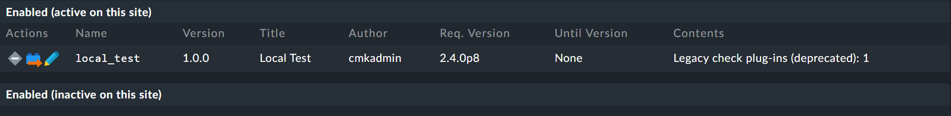

Here one screenshot of a system with 2.4.0p8
It shows only deprecated and is uses with the corrections.
Modified file is inside “~/local/share/check_mk/checks/”

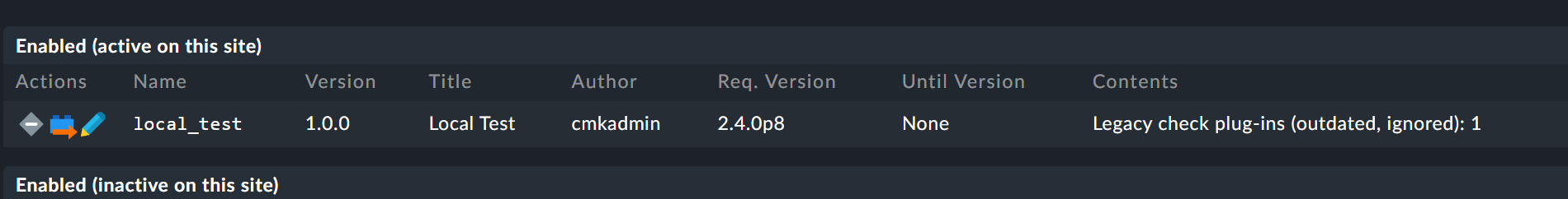

Same mkp inside 2.4.0p12
And it gets really ignored it is not only the writing there.
