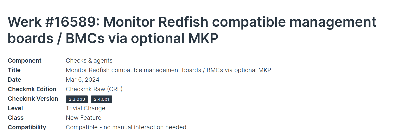

“You can now monitor Redfish compatible management boards / BMCs with Checkmk. To do so, please enable the natively shipped MKP redfish in Setup → Extension packages (in commercial editions of Checkmk) or via the command line tool mkp (in Checkmk Raw). This will enable a new datasource program under Setup → Other integrations → Redfish Compatible Management Controller . This is an experimental integration created by the Checkmk community (Andreas Döhler from Bechtle), which has already been tested in many environments. However, due to the diverse nature of server hardware, we plan to integrate it entirely for Checkmk 2.4.0, once we have gathered further feedback.”
The Redfish Python package is now also shipped with Checkmk and dependency management is done from our side thus as well. This is especially helpful for appliance users (@rprengel)
This sounds like an install of check-mk-raw-2.2.0p23-el8-38.x86_64.rpm will have everything needed to start using redfish. But I’m looking at the Other Integrations and redfish doesn’t show up. Is it just for 2.3 systems?
Please take a look at the werk which specifies the affected versions:
For 2.1 and 2.2 you have to install the python libraries manually like it is described in the info for the mkp package.
