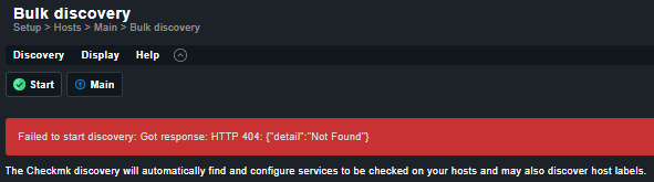

Can't activate changes, or bake a agent after upgrade to 2.4.0p4
CMK version: 2.4.0p4
OS version: RHEL 9.5
Error message: Failed to start discovery: Got response: HTTP 404: {“detail”:“Not Found”}
after updating from 2.3.0p30 → (latest) 2.3.0p34 → (latest) 2.4.0p4
eg. bulk changes

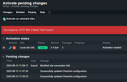

or Activate pending changes

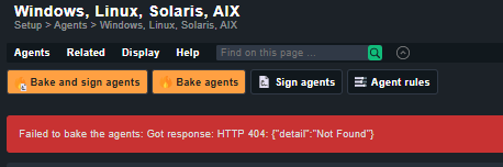

or bake agents

what could I do to investigate further?
