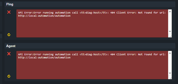

After upgrade to 2.4.0p8, connection tests fail with "API Error:Error running automation call"
CMK version: 2.4.0p8
OS version: Rocky Linux 9.5
Error message: API Error:Error running automation call diag-host: 404 Client Error: Not Found for url: http://local-automation/automation
after upgrading 2.3.0p34 → 2.4.0p8 (latest) I encounter this error on all monitored nodes:
save & run connection tests:

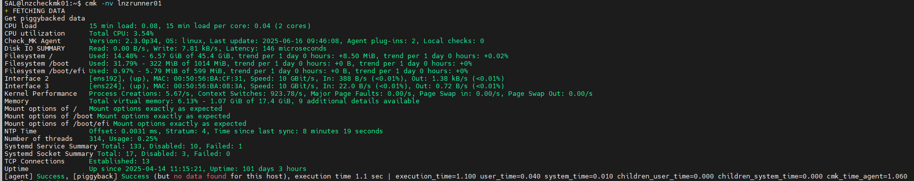

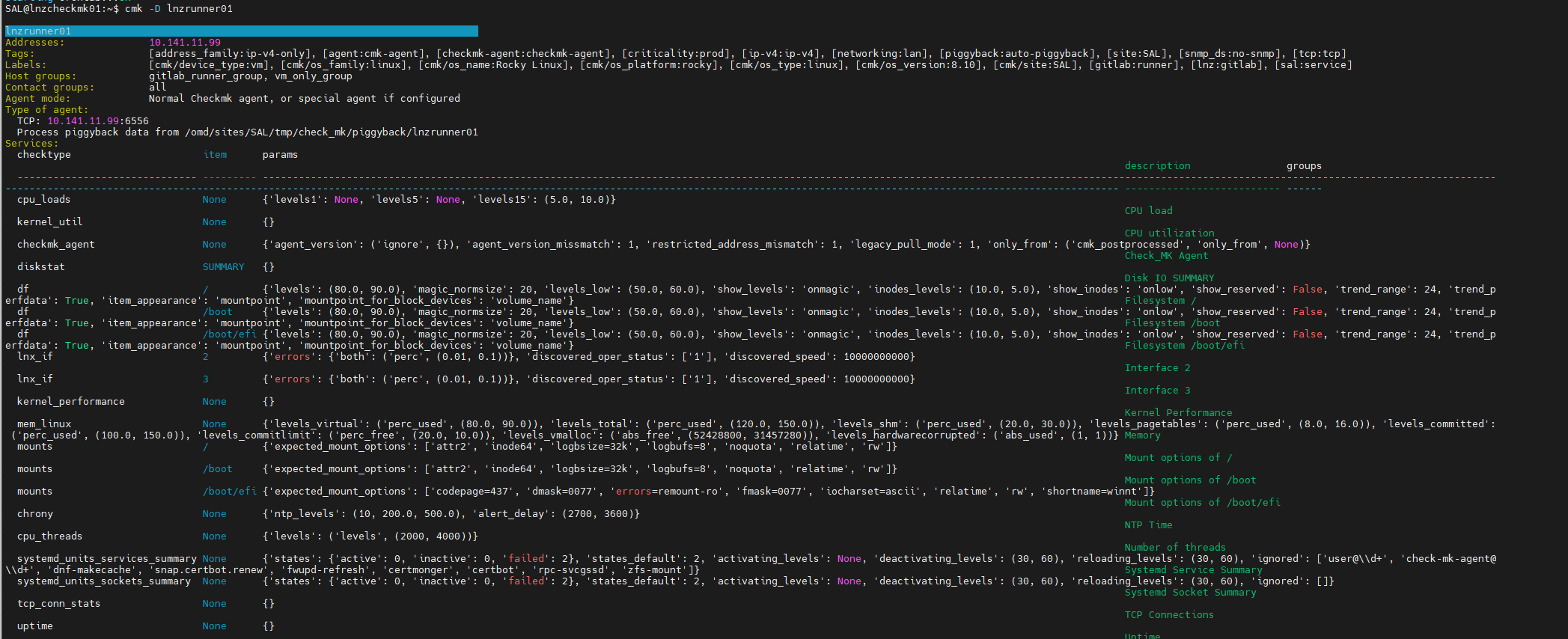

cmd-line checks:
cmk -D lnzrunner01
or cmk -nv lnzrunner01
or cmk -d lnzrunner01
so basically it looks good on the cmd-line, but not in the mgmt-interface.

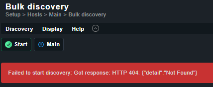

or doing a bulk-discovery shows:
the webserver log reveals:
$ tail -f var/log/web.log
2025-07-24 14:29:31,849 [40] [cmk.web 1040517] Failed to start bulk discovery
  File "/omd/sites/SAL/lib/python3/cmk/gui/wato/pages/bulk_discovery.py", line 138, in action
    raise result.error
cmk.gui.job_scheduler_client.StartupError: Got response: HTTP 404: {"detail":"Not Found"}
I raised a similiar topic in april this year Can't activate changes, or bake a agent after upgrade to 2.4.0p4 and still have no clue what’s going on.
So what is fine in 2.3.0p34 does not work in 2.4.0p8 .
There must be a significant change in this release which I’m not aware of…
I’ve been noticed about a werk change Werk #18305: Avoid "HTTP 404: {"detail":"Not Found"}" in Checkmk UI and REST API which will be published within the next release
Yes, this is the change which fixes this exact problem. If you want to test this, you can try one of our daily build.
