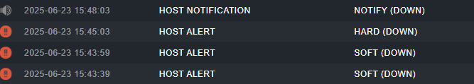

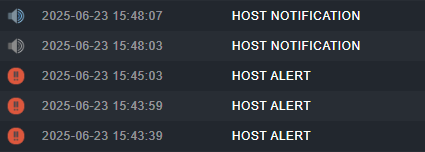

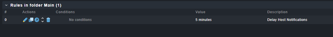

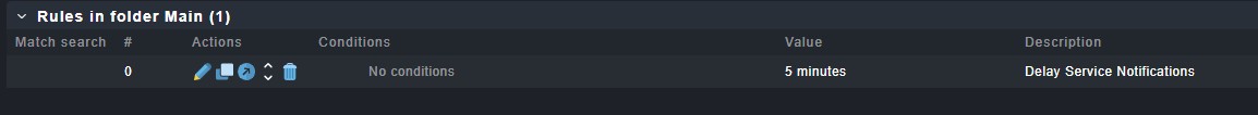

In the images
Delay for both Hosts & Services is set at 5 mins.
Host alert is 15:45
Host notification 15:48
that is 3 mins?

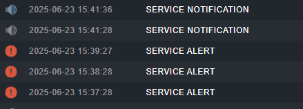

Service alert is 15:39
Service notification is 15:41
that 2 mins

Think I noticed something?
Is the notification created on the first alert,
or after the max check attempts?
Just checked the first 2 alerts in each are Soft, so no notification should be done,
but looking at the timings the notification is created on the first Soft alert?
per nagios documentation as andreas dug up last yearthe notification delay is calculated from the the first soft-state (the notification is of course only created on the hard state)
however this doesn’t fully explain it, as you would have 4 minutes in your service notification and 4m30s on your host notification example ![]()
