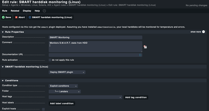

Yes I do, and I also think I already activated it correctly, but I could be wrong.
Setup>Agents>Linux>Agent Rules>SMART Harddisk Monitoring (linux) I activated this.
Do I need to do more?

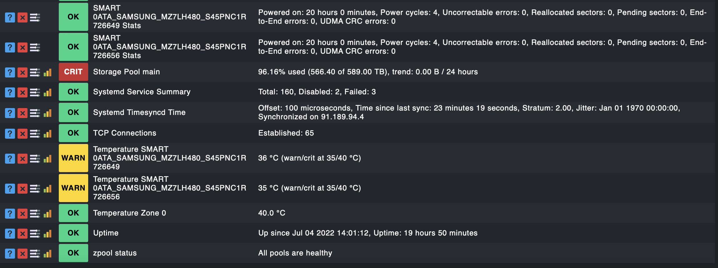

Thanks for both of your replies!
So, getting closer, I can now see the TEMP of two disks → the SSD drives that are directly attached to the motherboard and do not pass through the LSI controller. I’ve enabled the plugin from check_mk/agents/plugins/smart and I can now see four new services with SMART (see below).
How to make the smart service also spot the HDD’s behind my LSI controller?

This is what the smart plugin sees when I execute:
root@darmastorage01:/usr/lib/check_mk_agent/plugins# ./smart
tw_cli not found
<<<smart>>>
0ATA_SAMSUNG_MZ7LH480_S45PNC1R726649 ATA SAMSUNG_MZ7LH480   5 Reallocated_Sector_Ct   0x0033   100   100   010    Pre-fail  Always       -       0
0ATA_SAMSUNG_MZ7LH480_S45PNC1R726649 ATA SAMSUNG_MZ7LH480   9 Power_On_Hours          0x0032   099   099   000    Old_age   Always       -       23
0ATA_SAMSUNG_MZ7LH480_S45PNC1R726649 ATA SAMSUNG_MZ7LH480  12 Power_Cycle_Count       0x0032   099   099   000    Old_age   Always       -       4
0ATA_SAMSUNG_MZ7LH480_S45PNC1R726649 ATA SAMSUNG_MZ7LH480 177 Wear_Leveling_Count     0x0013   100   100   005    Pre-fail  Always       -       0
0ATA_SAMSUNG_MZ7LH480_S45PNC1R726649 ATA SAMSUNG_MZ7LH480 179 Used_Rsvd_Blk_Cnt_Tot   0x0013   100   100   010    Pre-fail  Always       -       0
0ATA_SAMSUNG_MZ7LH480_S45PNC1R726649 ATA SAMSUNG_MZ7LH480 180 Unused_Rsvd_Blk_Cnt_Tot 0x0013   100   100   010    Pre-fail  Always       -       1429
0ATA_SAMSUNG_MZ7LH480_S45PNC1R726649 ATA SAMSUNG_MZ7LH480 181 Program_Fail_Cnt_Total  0x0032   100   100   010    Old_age   Always       -       0
0ATA_SAMSUNG_MZ7LH480_S45PNC1R726649 ATA SAMSUNG_MZ7LH480 182 Erase_Fail_Count_Total  0x0032   100   100   010    Old_age   Always       -       0
0ATA_SAMSUNG_MZ7LH480_S45PNC1R726649 ATA SAMSUNG_MZ7LH480 183 Runtime_Bad_Block       0x0013   100   100   010    Pre-fail  Always       -       0
0ATA_SAMSUNG_MZ7LH480_S45PNC1R726649 ATA SAMSUNG_MZ7LH480 184 End-to-End_Error        0x0033   100   100   097    Pre-fail  Always       -       0
0ATA_SAMSUNG_MZ7LH480_S45PNC1R726649 ATA SAMSUNG_MZ7LH480 187 Uncorrectable_Error_Cnt 0x0032   100   100   000    Old_age   Always       -       0
0ATA_SAMSUNG_MZ7LH480_S45PNC1R726649 ATA SAMSUNG_MZ7LH480 194 Temperature_Celsius     0x0022   064   060   000    Old_age   Always       -       36 (Min/Max 27/37)
0ATA_SAMSUNG_MZ7LH480_S45PNC1R726649 ATA SAMSUNG_MZ7LH480 195 ECC_Error_Rate          0x001a   200   200   000    Old_age   Always       -       0
0ATA_SAMSUNG_MZ7LH480_S45PNC1R726649 ATA SAMSUNG_MZ7LH480 197 Current_Pending_Sector  0x0032   100   100   000    Old_age   Always       -       0
0ATA_SAMSUNG_MZ7LH480_S45PNC1R726649 ATA SAMSUNG_MZ7LH480 199 CRC_Error_Count         0x003e   100   100   000    Old_age   Always       -       0
0ATA_SAMSUNG_MZ7LH480_S45PNC1R726649 ATA SAMSUNG_MZ7LH480 202 Exception_Mode_Status   0x0033   100   100   010    Pre-fail  Always       -       0
0ATA_SAMSUNG_MZ7LH480_S45PNC1R726649 ATA SAMSUNG_MZ7LH480 235 POR_Recovery_Count      0x0012   099   099   000    Old_age   Always       -       2
0ATA_SAMSUNG_MZ7LH480_S45PNC1R726649 ATA SAMSUNG_MZ7LH480 241 Total_LBAs_Written      0x0032   099   099   000    Old_age   Always       -       32012228
0ATA_SAMSUNG_MZ7LH480_S45PNC1R726649 ATA SAMSUNG_MZ7LH480 242 Total_LBAs_Read         0x0032   099   099   000    Old_age   Always       -       2603916
0ATA_SAMSUNG_MZ7LH480_S45PNC1R726649 ATA SAMSUNG_MZ7LH480 243 SATA_Downshift_Ct       0x0032   100   100   000    Old_age   Always       -       0
0ATA_SAMSUNG_MZ7LH480_S45PNC1R726649 ATA SAMSUNG_MZ7LH480 244 Thermal_Throttle_St     0x0032   100   100   000    Old_age   Always       -       0
0ATA_SAMSUNG_MZ7LH480_S45PNC1R726649 ATA SAMSUNG_MZ7LH480 245 Timed_Workld_Media_Wear 0x0032   100   100   000    Old_age   Always       -       65535
0ATA_SAMSUNG_MZ7LH480_S45PNC1R726649 ATA SAMSUNG_MZ7LH480 246 Timed_Workld_RdWr_Ratio 0x0032   100   100   000    Old_age   Always       -       65535
0ATA_SAMSUNG_MZ7LH480_S45PNC1R726649 ATA SAMSUNG_MZ7LH480 247 Timed_Workld_Timer      0x0032   100   100   000    Old_age   Always       -       65535
0ATA_SAMSUNG_MZ7LH480_S45PNC1R726649 ATA SAMSUNG_MZ7LH480 251 NAND_Writes             0x0032   100   100   000    Old_age   Always       -       32776256
0ATA_SAMSUNG_MZ7LH480_S45PNC1R726656 ATA SAMSUNG_MZ7LH480   5 Reallocated_Sector_Ct   0x0033   100   100   010    Pre-fail  Always       -       0
0ATA_SAMSUNG_MZ7LH480_S45PNC1R726656 ATA SAMSUNG_MZ7LH480   9 Power_On_Hours          0x0032   099   099   000    Old_age   Always       -       23
0ATA_SAMSUNG_MZ7LH480_S45PNC1R726656 ATA SAMSUNG_MZ7LH480  12 Power_Cycle_Count       0x0032   099   099   000    Old_age   Always       -       4
0ATA_SAMSUNG_MZ7LH480_S45PNC1R726656 ATA SAMSUNG_MZ7LH480 177 Wear_Leveling_Count     0x0013   100   100   005    Pre-fail  Always       -       0
0ATA_SAMSUNG_MZ7LH480_S45PNC1R726656 ATA SAMSUNG_MZ7LH480 179 Used_Rsvd_Blk_Cnt_Tot   0x0013   100   100   010    Pre-fail  Always       -       0
0ATA_SAMSUNG_MZ7LH480_S45PNC1R726656 ATA SAMSUNG_MZ7LH480 180 Unused_Rsvd_Blk_Cnt_Tot 0x0013   100   100   010    Pre-fail  Always       -       1435
0ATA_SAMSUNG_MZ7LH480_S45PNC1R726656 ATA SAMSUNG_MZ7LH480 181 Program_Fail_Cnt_Total  0x0032   100   100   010    Old_age   Always       -       0
0ATA_SAMSUNG_MZ7LH480_S45PNC1R726656 ATA SAMSUNG_MZ7LH480 182 Erase_Fail_Count_Total  0x0032   100   100   010    Old_age   Always       -       0
0ATA_SAMSUNG_MZ7LH480_S45PNC1R726656 ATA SAMSUNG_MZ7LH480 183 Runtime_Bad_Block       0x0013   100   100   010    Pre-fail  Always       -       0
0ATA_SAMSUNG_MZ7LH480_S45PNC1R726656 ATA SAMSUNG_MZ7LH480 184 End-to-End_Error        0x0033   100   100   097    Pre-fail  Always       -       0
0ATA_SAMSUNG_MZ7LH480_S45PNC1R726656 ATA SAMSUNG_MZ7LH480 187 Uncorrectable_Error_Cnt 0x0032   100   100   000    Old_age   Always       -       0
0ATA_SAMSUNG_MZ7LH480_S45PNC1R726656 ATA SAMSUNG_MZ7LH480 194 Temperature_Celsius     0x0022   064   060   000    Old_age   Always       -       36 (Min/Max 27/36)
0ATA_SAMSUNG_MZ7LH480_S45PNC1R726656 ATA SAMSUNG_MZ7LH480 195 ECC_Error_Rate          0x001a   200   200   000    Old_age   Always       -       0
0ATA_SAMSUNG_MZ7LH480_S45PNC1R726656 ATA SAMSUNG_MZ7LH480 197 Current_Pending_Sector  0x0032   100   100   000    Old_age   Always       -       0
0ATA_SAMSUNG_MZ7LH480_S45PNC1R726656 ATA SAMSUNG_MZ7LH480 199 CRC_Error_Count         0x003e   100   100   000    Old_age   Always       -       0
0ATA_SAMSUNG_MZ7LH480_S45PNC1R726656 ATA SAMSUNG_MZ7LH480 202 Exception_Mode_Status   0x0033   100   100   010    Pre-fail  Always       -       0
0ATA_SAMSUNG_MZ7LH480_S45PNC1R726656 ATA SAMSUNG_MZ7LH480 235 POR_Recovery_Count      0x0012   099   099   000    Old_age   Always       -       2
0ATA_SAMSUNG_MZ7LH480_S45PNC1R726656 ATA SAMSUNG_MZ7LH480 241 Total_LBAs_Written      0x0032   100   100   000    Old_age   Always       -       0
0ATA_SAMSUNG_MZ7LH480_S45PNC1R726656 ATA SAMSUNG_MZ7LH480 242 Total_LBAs_Read         0x0032   099   099   000    Old_age   Always       -       188429
0ATA_SAMSUNG_MZ7LH480_S45PNC1R726656 ATA SAMSUNG_MZ7LH480 243 SATA_Downshift_Ct       0x0032   100   100   000    Old_age   Always       -       0
0ATA_SAMSUNG_MZ7LH480_S45PNC1R726656 ATA SAMSUNG_MZ7LH480 244 Thermal_Throttle_St     0x0032   100   100   000    Old_age   Always       -       0
0ATA_SAMSUNG_MZ7LH480_S45PNC1R726656 ATA SAMSUNG_MZ7LH480 245 Timed_Workld_Media_Wear 0x0032   100   100   000    Old_age   Always       -       65535
0ATA_SAMSUNG_MZ7LH480_S45PNC1R726656 ATA SAMSUNG_MZ7LH480 246 Timed_Workld_RdWr_Ratio 0x0032   100   100   000    Old_age   Always       -       65535
0ATA_SAMSUNG_MZ7LH480_S45PNC1R726656 ATA SAMSUNG_MZ7LH480 247 Timed_Workld_Timer      0x0032   100   100   000    Old_age   Always       -       65535
0ATA_SAMSUNG_MZ7LH480_S45PNC1R726656 ATA SAMSUNG_MZ7LH480 251 NAND_Writes             0x0032   100   100   000    Old_age   Always       -       0
These are only the SSD’s that are directly on the motherboard.
Here are the full bash reads from running the smart file: Smart CheckMK - Pastebin.com
