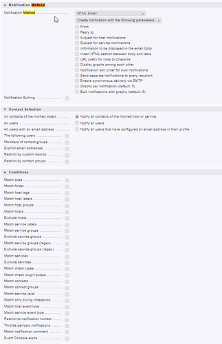

Hello Andre
I don’t seem to have the option for “Periodic notifications during host|service problems”
in the notification method

Its a setup ruleset, not a rule in the notification part
