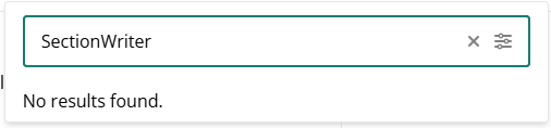

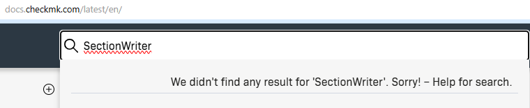

Please don’t forget to mention the “SectionWriter” for the output of the special agent. I searched the forum and the docs and currently have no idea where I picked this information up:
“SectionWriter” is only used by special agents and a little bit more niche than the “normal” check writing. :wink:
The bigger problem for “SectionWriter” is, that it comes from a not official released API –> cmk.special_agents.v0_unstable and will be the reason that you cannot find it inside the docs.
If i look at the current master branch this v0_unstable API is completely gone –> that means don’t use it anymore now !!!
