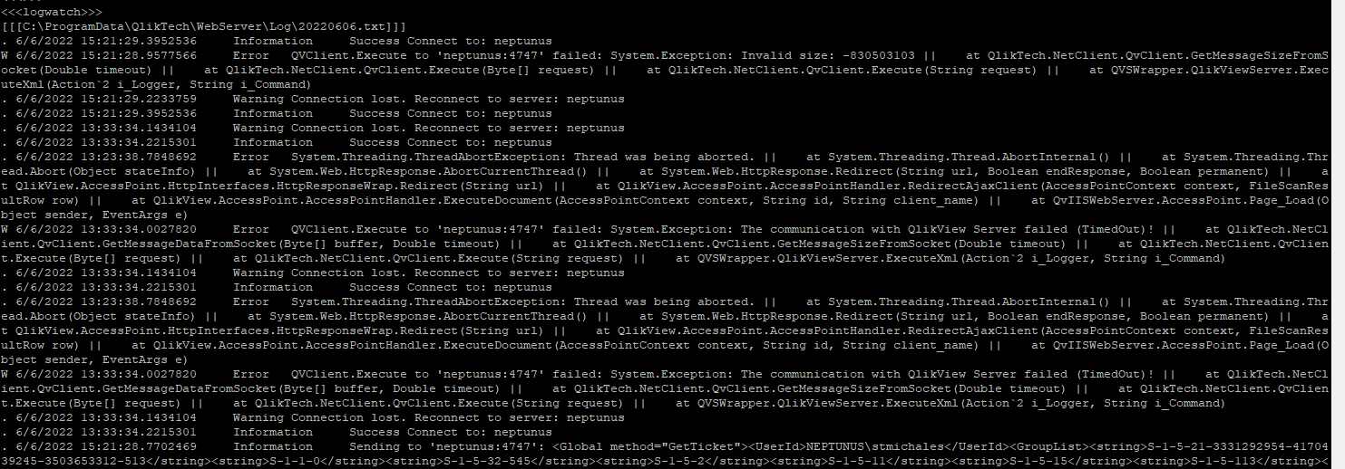

Hey @davidwayne
I’ve done that already, following @louis instructions, but when I test the agent by executing it on the command line, I get the normal output but I can’t find a mention anywhere from that logfile I am trying to watch.
Is there something I need to ‘enable’ or should it pick up cfg + exe on its own?
I can see it executing here:
2022-06-16 14:03:59.172 [app 1028] [Trace] Left [38] files to execute
2022-06-16 14:03:59.175 [app 1028] Plugin ‘C:\ProgramData\checkmk\agent\plugins\mk_logwatch.exe’ is sync with age:0 timeout:60 retry:0
2022-06-16 14:03:59.175 [app 1028] Plugin ‘C:\ProgramData\checkmk\agent\plugins\windows_updates.vbs’ is sync with age:0 timeout:60 retry:0
2022-06-16 14:03:59.175 [app 1028] [Trace] Left [2] files to execute in ‘plugins’

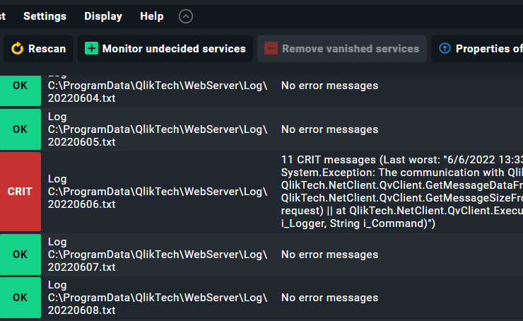

Hi
After a reinstall of the agent and a reconfigure of the agent, the detection works.
Now, the only remaining issue is that I don’t see the generated warnings in my main dashboard.
Should I do something special before the check appears?
If you now see your configured log file inside CMK, it can only be the definition of the lines it should find.
It would help if you define first a very common pattern inside the “logwatch.cfg” to see that data is transferred to CMK server.
The transferred lines should then be visible inside the “Log …” service on your monitored machine.
Hey
The lines are coded correctly
See the ‘W’ in the first line, the only issue remaining is that I don’t see it in my main dashboard, it does not show up.
Is there anything I need to ‘activate’ to get this to display on the GUI side?

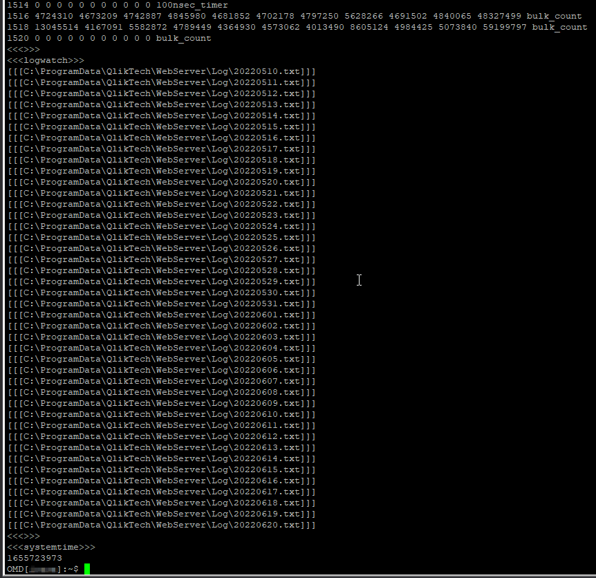

The full log can be seen here:

<<<logwatch>>>
[[[Application]]]
[[[Bullzip PDF Printer]]]
[[[HardwareEvents]]]
[[[Internet Explorer]]]
[[[Kaspersky Endpoint Security]]]
[[[Kaspersky Event Log]]]
[[[Kaspersky Security]]]
[[[Key Management Service]]]
[[[OAlerts]]]
[[[Security]]]
[[[System]]]
[[[Windows PowerShell]]]

<<<ps:sep(9)>>>
(SYSTEM,64,4,0,0,0,0,2943998437500,0,10,30234)	System Idle Process
(SYSTEM,3392,268,0,4,0,0,2306250000,1021,177,30234)	System
(SYSTEM,4400,1020,0,400,0,0,4531250,55,2,30234)	smss.exe
(SYSTEM,60852,5760,0,508,2,14218750,19218750,568,22,30232)	csrss.exe
(\\NT AUTHORITY\SYSTEM,2147524796,4100,0,592,0,0,937500,86,1,30232)	wininit.exe
(SYSTEM,40132,3524,0,600,1,0,312500,99,8,30232)	csrss.exe
(\\NT AUTHORITY\SYSTEM,2147535576,5976,0,628,1,312500,781250,126,2,30232)	winlogon.exe
(SYSTEM,2147521448,9292,0,684,5,1034062500,1802500000,338,5,30232)	services.exe
(\\NT AUTHORITY\SYSTEM,2147551788,21376,0,692,11,128281250,68437500,2538,9,30232)	lsass.exe
(\\NT AUTHORITY\SYSTEM,2147557136,12312,0,760,4,7031250,6562500,440,8,30231)	svchost.exe
(\\NT AUTHORITY\NETWORK SERVICE,2147550480,9072,0,792,4,11093750,4687500,471,9,30230)	svchost.exe
(\\NT AUTHORITY\SYSTEM,2147621212,25092,0,892,12,468750,1406250,303,7,30230)	LogonUI.exe
(\\Window Manager\DWM-1,2147573320,25104,0,900,14,156250,312500,183,6,30230)	dwm.exe
(\\NT AUTHORITY\LOCAL SERVICE,2147542748,15032,0,908,11,89687500,84375000,476,13,30230)	svchost.exe
(\\NT AUTHORITY\SYSTEM,2147627468,40528,0,936,25,227968750,105937500,1431,46,30230)	svchost.exe
(\\NT AUTHORITY\LOCAL SERVICE,2147570748,11616,0,988,5,10781250,14062500,645,13,30230)	svchost.exe
(\\NT AUTHORITY\SYSTEM,150708,18476,0,452,10,6406250,2031250,233,20,30230)	proton.exe
(\\NT AUTHORITY\SYSTEM,110632,29272,0,604,16,94843750,188281250,410,11,30230)	kavfs.exe
(\\NT AUTHORITY\SYSTEM,62652,10240,0,480,3,4218750,3125000,410,6,30229)	kavfswh.exe
(\\NT AUTHORITY\SYSTEM,365256,61856,0,788,40,156406250,18906250,889,18,30229)	soyuz.exe
(\\NT AUTHORITY\SYSTEM,136312,26060,0,1064,12,2766875000,332656250,536,16,30224)	kavfswp.exe
(\\NT AUTHORITY\SYSTEM,195716,27944,0,1100,17,843125000,80468750,294,11,30224)	kavfswp.exe
(\\NT AUTHORITY\SYSTEM,376028,51580,0,1144,87,1528906250,252031250,600,33,30223)	kavfswp.exe
(\\NT AUTHORITY\NETWORK SERVICE,2147555544,11896,0,1432,5,5312500,10156250,481,16,30146)	svchost.exe
(\\NT AUTHORITY\LOCAL SERVICE,2147533576,11260,0,1600,6,1875000,2187500,363,17,30146)	svchost.exe
(\\NT AUTHORITY\SYSTEM,2147561780,11292,0,1816,4,8281250,6406250,396,10,30146)	spoolsv.exe
(\\NT AUTHORITY\SYSTEM,76804,4304,0,1864,1,0,156250,82,3,30146)	armsvc.exe
(\\NT AUTHORITY\SYSTEM,2147526444,9212,0,1880,3,156250,0,126,8,30146)	svchost.exe
(\\NT AUTHORITY\SYSTEM,88696,14216,0,1896,7,474062500,331562500,347,21,30146)	check_mk_agent.exe
(\\NT AUTHORITY\NETWORK SERVICE,2149636096,10820,0,2004,3,7968750,2031250,282,5,30145)	svchost.exe
(\\NT AUTHORITY\SYSTEM,2147583992,9244,0,2020,3,1562500,1093750,200,9,30145)	svchost.exe
(\\NT AUTHORITY\SYSTEM,69100,21628,0,1296,14,156250,312500,156,4,30145)	inetinfo.exe
(\\NT AUTHORITY\LOCAL SERVICE,557348,20504,0,1768,23,6250000,5468750,214,7,30145)	SMSvcHost.exe
(\\NEPTUNUS\SRV_Qlikview,681660,87396,0,1952,78,20312500,3281250,685,8,30144)	QVDirectoryServiceConnector.exe
(\\NEPTUNUS\SRV_Qlikview,13831624,235100,0,2068,354,401875000,130937500,1159,87,30144)	QVDistributionService.exe
(\\NEPTUNUS\SRV_Qlikview,753716,73444,0,2164,58,37656250,7968750,778,27,30144)	QVManagementService.exe
(\\NEPTUNUS\SRV_Qlikview,58821948,27876664,0,2208,27457,19505000000,2309687500,787,61,30144)	QVS.exe
(\\NEPTUNUS\SRV_Qlikview,599860,42836,0,2416,41,1250000,1250000,650,7,30143)	QVWebServerSettingsService.exe
(\\NT AUTHORITY\SYSTEM,96656,14496,0,2508,5,1562500,937500,400,24,30142)	TeamViewer_Service.exe
(\\NT AUTHORITY\SYSTEM,2150197580,14352,0,2548,11,625000,937500,369,12,30142)	svchost.exe
(\\NT AUTHORITY\SYSTEM,71248,10520,0,2576,4,937500,1718750,121,3,30142)	VGAuthService.exe
(\\NT AUTHORITY\SYSTEM,2147532008,4356,0,2624,1,468750,468750,95,3,30142)	vm3dservice.exe
(\\NT AUTHORITY\SYSTEM,2147532984,4500,0,2648,1,0,156250,87,1,30142)	vm3dservice.exe
(\\NT AUTHORITY\SYSTEM,99420,18860,0,2656,8,63437500,10000000,349,8,30142)	vmtoolsd.exe
(\\NT AUTHORITY\SYSTEM,2147535232,10660,0,2684,5,7031250,6718750,192,21,30142)	svchost.exe
(\\NT AUTHORITY\SYSTEM,73556,9192,0,2788,2,10781250,7500000,181,4,30142)	OcsService.exe
(\\NT AUTHORITY\NETWORK SERVICE,2147589584,28564,0,3096,18,707968750,282812500,617,15,30141)	WmiPrvSE.exe
(\\NT AUTHORITY\SYSTEM,2147598000,34504,0,3124,26,120468750,437500000,520,18,30141)	WmiPrvSE.exe
(\\IIS APPPOOL\DefaultAppPool,13484500,46492,0,4072,186,7031250,2500000,1080,55,30116)	w3wp.exe
(\\NEPTUNUS\Administrator,2147512040,5208,0,1652,1,156250,625000,106,2,30108)	taskeng.exe
(\\NT AUTHORITY\NETWORK SERVICE,2147692588,74196,0,4848,65,15625000,8593750,742,55,30058)	svchost.exe
(\\NT AUTHORITY\NETWORK SERVICE,2147506044,4952,0,4916,1,0,0,115,4,30058)	svchost.exe
(\\NT AUTHORITY\SYSTEM,2147535340,11224,0,4956,3,312500,468750,205,11,30058)	dllhost.exe
(\\NT AUTHORITY\NETWORK SERVICE,2147527284,7564,0,5088,2,781250,625000,159,10,30058)	msdtc.exe
(\\NT AUTHORITY\SYSTEM,260976,32112,0,1192,22,265625000,128125000,826,37,29937)	klnagent.exe
(\\NT AUTHORITY\SYSTEM,2147545116,8020,0,4420,2,156250,156250,177,4,29931)	svchost.exe
(SYSTEM,66400,25040,0,1384,1,937500,6250000,251,10,8843)	csrss.exe
(\\NT AUTHORITY\SYSTEM,2147552264,7524,0,5668,1,156250,937500,170,2,8843)	winlogon.exe
(\\Window Manager\DWM-2,2147628896,55532,0,6040,13,156250,1250000,200,8,8841)	dwm.exe
(\\NEPTUNUS\Administrator,2148755204,9356,0,1984,3,0,468750,213,5,8838)	taskhostex.exe
(SYSTEM,2147542328,13000,0,4840,4,53281250,1718750,198,3,8838)	sppsvc.exe
(\\NEPTUNUS\Administrator,2147572428,9460,0,5664,2,625000,781250,260,8,8838)	rdpclip.exe
(\\NEPTUNUS\Administrator,2148040296,126136,0,1580,58,24375000,26250000,1411,47,8835)	explorer.exe
(\\NT AUTHORITY\NETWORK SERVICE,55332,6400,0,6280,1,156250,156250,124,1,8833)	SppExtComObj.Exe
(\\NEPTUNUS\Administrator,104352,10824,0,6544,3,31093750,17343750,161,4,8824)	vmtoolsd.exe
(\\NEPTUNUS\Administrator,105004,8268,0,6588,2,156250,0,108,3,8823)	OcsSystray.exe
(\\NEPTUNUS\Administrator,70912,7104,0,6688,1,312500,781250,131,1,8823)	kmlisten.exe
(\\NEPTUNUS\Administrator,78384,7044,0,6748,2,0,0,122,4,8822)	kavtray.exe
(\\NEPTUNUS\Administrator,72680,5348,0,6820,1,468750,937500,104,2,8822)	adb.exe
(\\NEPTUNUS\SRV_Qlikview,13523480,141888,0,6016,271,47968750,8281250,920,69,8118)	w3wp.exe
(\\NEPTUNUS\Administrator,74996,72,0,5552,0,0,0,2,1,8114)	RdrCEF.exe
(\\NEPTUNUS\Administrator,2147535860,6124,0,3224,1,0,156250,111,2,7368)	taskeng.exe
(\\NEPTUNUS\Administrator,157348,35876,0,5720,16,30156250,25156250,253,2,1652)	notepad++.exe
(\\NT AUTHORITY\LOCAL SERVICE,2147526820,10648,0,4016,5,625000,2031250,271,9,1602)	WmiPrvSE.exe
(\\NT AUTHORITY\SYSTEM,2147519692,6960,0,5324,1,312500,156250,140,4,313)	WmiApSrv.exe
(\\NT AUTHORITY\SYSTEM,5464,72,0,3472,0,0,0,0,1,0)	check_mk_agent.exe

<<<logwatch>>>
[[[C:\ProgramData\QlikTech\WebServer\Log\20220510.txt]]]
[[[C:\ProgramData\QlikTech\WebServer\Log\20220511.txt]]]
[[[C:\ProgramData\QlikTech\WebServer\Log\20220512.txt]]]
[[[C:\ProgramData\QlikTech\WebServer\Log\20220513.txt]]]
[[[C:\ProgramData\QlikTech\WebServer\Log\20220514.txt]]]
[[[C:\ProgramData\QlikTech\WebServer\Log\20220515.txt]]]
[[[C:\ProgramData\QlikTech\WebServer\Log\20220516.txt]]]
[[[C:\ProgramData\QlikTech\WebServer\Log\20220517.txt]]]
[[[C:\ProgramData\QlikTech\WebServer\Log\20220518.txt]]]
[[[C:\ProgramData\QlikTech\WebServer\Log\20220519.txt]]]
[[[C:\ProgramData\QlikTech\WebServer\Log\20220520.txt]]]
[[[C:\ProgramData\QlikTech\WebServer\Log\20220521.txt]]]
[[[C:\ProgramData\QlikTech\WebServer\Log\20220522.txt]]]
[[[C:\ProgramData\QlikTech\WebServer\Log\20220523.txt]]]
[[[C:\ProgramData\QlikTech\WebServer\Log\20220524.txt]]]
[[[C:\ProgramData\QlikTech\WebServer\Log\20220525.txt]]]
[[[C:\ProgramData\QlikTech\WebServer\Log\20220526.txt]]]
[[[C:\ProgramData\QlikTech\WebServer\Log\20220527.txt]]]
[[[C:\ProgramData\QlikTech\WebServer\Log\20220528.txt]]]
[[[C:\ProgramData\QlikTech\WebServer\Log\20220529.txt]]]
[[[C:\ProgramData\QlikTech\WebServer\Log\20220530.txt]]]
[[[C:\ProgramData\QlikTech\WebServer\Log\20220531.txt]]]
[[[C:\ProgramData\QlikTech\WebServer\Log\20220601.txt]]]
[[[C:\ProgramData\QlikTech\WebServer\Log\20220602.txt]]]
[[[C:\ProgramData\QlikTech\WebServer\Log\20220603.txt]]]
[[[C:\ProgramData\QlikTech\WebServer\Log\20220604.txt]]]
[[[C:\ProgramData\QlikTech\WebServer\Log\20220605.txt]]]
[[[C:\ProgramData\QlikTech\WebServer\Log\20220606.txt]]]
. 6/6/2022 13:33:34.2215301     Information     Success Connect to: neptunus
. 6/6/2022 13:23:38.7848692     Error   System.Threading.ThreadAbortException: Thread was being aborted. ||    at System.Threading.Thread.AbortInternal() ||    at System.Threading.Thread.Abort(Object stateInfo) ||    at System.Web.HttpResponse.AbortCurrentThread() ||    at System.Web.HttpResponse.Redirect(String url, Boolean endResponse, Boolean permanent) ||    at QlikView.AccessPoint.HttpInterfaces.HttpResponseWrap.Redirect(String url) ||    at QlikView.AccessPoint.AccessPointHandler.RedirectAjaxClient(AccessPointContext context, FileScanResultRow row) ||    at QlikView.AccessPoint.AccessPointHandler.ExecuteDocument(AccessPointContext context, String id, String client_name) ||    at QvIISWebServer.AccessPoint.Page_Load(Object sender, EventArgs e)
C 6/6/2022 13:33:34.0027820     Error   QVClient.Execute to 'neptunus:4747' failed: System.Exception: The communication with QlikView Server failed (TimedOut)! ||    at QlikTech.NetClient.QvClient.GetMessageDataFromSocket(Byte[] buffer, Double timeout) ||    at QlikTech.NetClient.QvClient.GetMessageSizeFromSocket(Double timeout) ||    at QlikTech.NetClient.QvClient.Execute(Byte[] request) ||    at QlikTech.NetClient.QvClient.Execute(String request) ||    at QVSWrapper.QlikViewServer.ExecuteXml(Action`2 i_Logger, String i_Command)
. 6/6/2022 13:33:34.1434104     Warning Connection lost. Reconnect to server: neptunus
. 6/6/2022 15:21:28.7702469     Information     Sending to 'neptunus:4747': <Global method="GetTicket"><UserId>NEPTUNUS\stmichales</UserId><GroupList><string>S-1-5-21-3331292954-4170439245-3503653312-513</string><string>S-1-1-0</string><string>S-1-5-32-545</string><string>S-1-5-2</string><string>S-1-5-11</string><string>S-1-5-15</string><string>S-1-5-113</string><string>S-1-5-64-10</string></GroupList><GroupListIsNames>false</GroupListIsNames></Global>
. 6/6/2022 15:21:28.8171225     Error   System.Threading.ThreadAbortException: Thread was being aborted. ||    at QlikView.AccessPoint.FileScan.ScanQlikViewServerClusters(IEnumerable`1 servers, Action`2 logger, IUser user, Int32& liveQvsCount, Boolean respectBrowsable) ||    at QlikView.AccessPoint.AccessPointContext.UpdateRowList(Boolean forceUpdate) ||    at QlikView.AccessPoint.AccessPointContext.UpdateData(Boolean forceUpdate) ||    at QlikView.AccessPoint.AccessPointHandler.ExecuteXML(AccessPointContext context, String request) ||    at QvIISWebServer.AccessPoint.Page_Load(Object sender, EventArgs e)
C 6/6/2022 15:21:28.9577566     Error   QVClient.Execute to 'neptunus:4747' failed: System.Exception: Invalid size: -830503103 ||    at QlikTech.NetClient.QvClient.GetMessageSizeFromSocket(Double timeout) ||    at QlikTech.NetClient.QvClient.Execute(Byte[] request) ||    at QlikTech.NetClient.QvClient.Execute(String request) ||    at QVSWrapper.QlikViewServer.ExecuteXml(Action`2 i_Logger, String i_Command)
. 6/6/2022 15:21:29.2233759     Warning Connection lost. Reconnect to server: neptunus
. 6/6/2022 15:21:29.3952536     Information     Success Connect to: neptunus

We are now at the stage that agent is seeing the log files and sending them with the standard output to the server but it seems the server isn’t doing anything with that output.
I can’t see it when I do a full service scan, is there an enforcement rule that I can apply to force CheckMK server to pick it up?
Here you can see the files actually being picked up:
@andreas-doehler : The log shows it can find the configured log files and sends them to the server

OK, I’ve been banging my head against this problem and it seems a previous maintainer of the site outright disabled all the logwatch check on site level.
I’ve got no idea why, I deleted that rule and now everything comes in as it should!
Thanks for all the advice, it was greatly appreciated!
