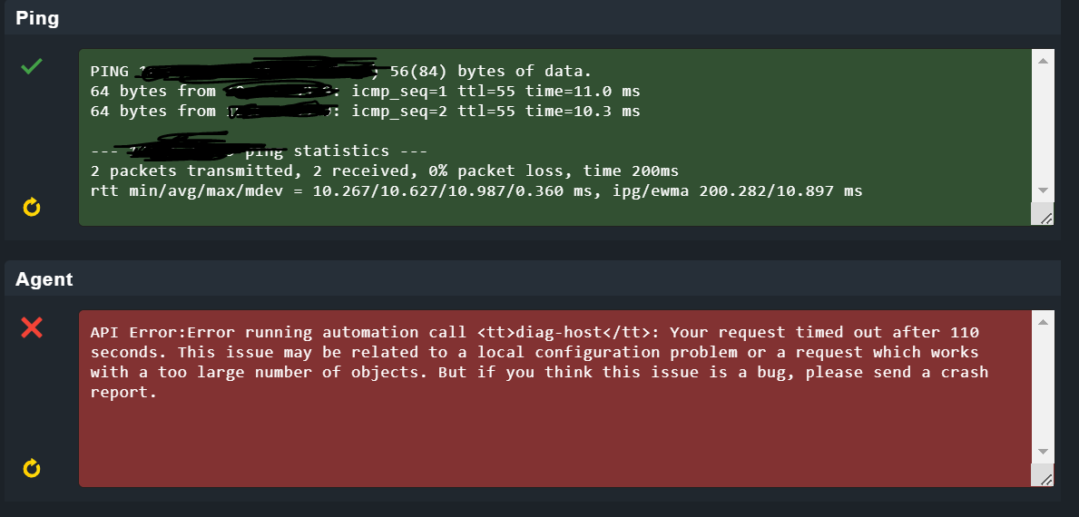

We are trying to monitor our Vcenter server from Checkmk, followed this documentation:

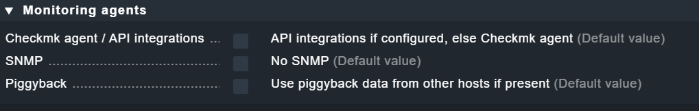

But , in host properties, what should we give on the agent part , we have left default
and when I am trying to run the connection test getting this error, although my ping is responding perfectly

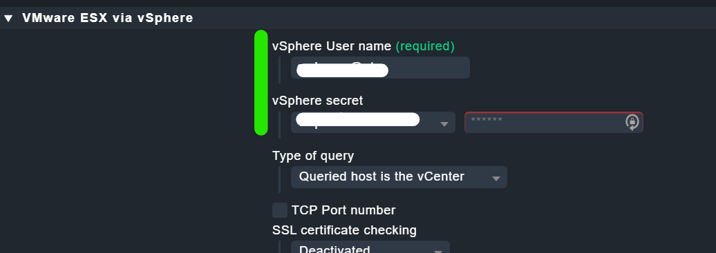

Also the rule is configured (VMWare ESX via Vsphere)

firewall? maybe?
user for access to esx works?
Well, the ping is working from checkmk to Vcenter server, also since vcenter is an appliance and we are managing it through VMware ESX rule from checkmk then what other port needs to be opened?
We are using root login credentials of Vcenter in the VMware ESX via vSphere.
BR
//Prachi
ping → ok…
the special agent use https/443
telnet 443?
in case of security, i would recommend you to create a “read only” user on your vcenter for using it in cmk.

Yes telnet 443 is not working from checkmk to vcenter server and so I feel its giving api error…

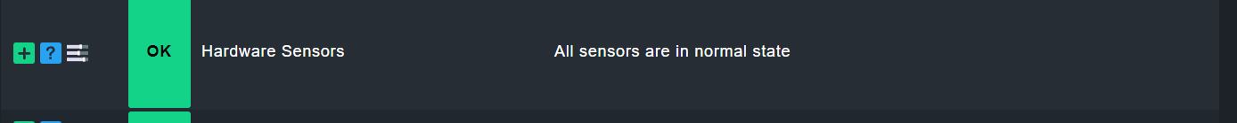

Not via vSphere, you need to monitor the ESX host direct. For that you have an option in the VMware rule.
You will get then the check Hardware Sensors:
This check checks the state of all of a VMWare ESX host system's hardware sensors - including temperatures, fans, power supplies, memory DIMMS, hard disk, an others. In order to avoid network traffic the agent sends only information about sensors that are not in green state.
Note: Due to a caching problem on the ESX host system side, this check occasionally reports incorrect sensor data. This may mean that the sensor appears to be stuck in an unhealthy state. You can find more information here: http://kb.vmware.com/selfservice/microsites/search.do?cmd=displayKC&externalId=1037330
Basically its using IPMI locally in ESX OS.

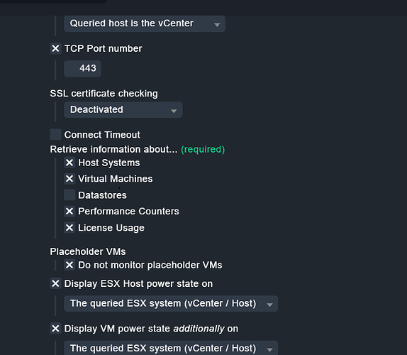

  1. Vcenter, esxi host - Vmware ESX via vSphere (TCP 443)

Yes, absolutely…in few of our Dell esxi hosts which we are monitoring via Vmware ESX via Vsphere rule, could see Hardware sensors in services…that means this parameter hardware sensor is related to the hardware on which the esx is installed.
Good to know, I had put it in disabled service, will put this in monitored service now:)
