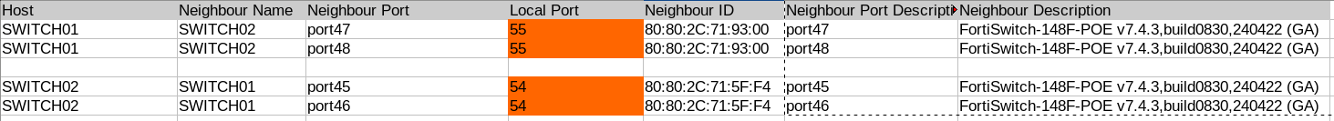

Here is a short update on LLDP and Fortinet:
  • Issue 1: Fortinet uses a different format for MAC addresses than inv_lldp_cache knew → this is now fixed inv_lldp_cache-0.9.9-20240724.mkp
  • Issue 2: Fortigate has a “creative” way to use the LLDP data. Specifically, Fortinet enters the port aggregations in the LLDP table, without interface mapping for the local port to the LLDP port table, but only the interface index for the port aggregation. The remote ports are OK. In the topology it looks like this
This are the LLDP data on which this is based
and to complete this the interface data
I have now added a tweak for Fortinet to inv_lldp_cache (not yet online). This will map the information for the port aggregation to the LLDP data. So the topology is ok.
The disadvantage is, that I have not yet found a way to read out which port from the port aggregation is actually connected to which neighboring port :frowning: I simply map the first port from the aggregation to the first neighboring port, the second to the second and so on. So if anyone here has any ideas…

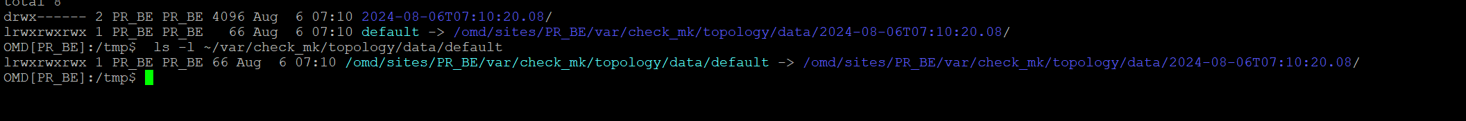

Hello I have trouble to get this running. We are currently running 2.3.0p10 version so according comments above this plugin is already included. I had already install additional plugins -cdp, lldp, inv_ifname and nvdct as well. HW/SW intentory is providing data - I can see cdp and lldp cache and neighbours. All host are Cisco switches, enable for monitoring including all services - ports.
Json file with cdp is generated but I can see any drop down menu to see network layer topology from aby of enabled hosts in site.
Any advice please ?
Can you show an
ls -l ~/var/check_mk/topology/data
and an
ls ~/var/check_mk/topology/data/default/
please.
That’s another weird issue what i had noticed. After some time symlink @default is gone. Same with my custom config file located under ~/local/bin/nvdct/conf/.
I had to do it all over again this morning.

Here is output of the directory:
OMD[PR_BE]:~/var/check_mk/topology/data$ ls -l ~/var/check_mk/topology/data
total 8
drwx------ 2 PR_BE PR_BE 4096 Aug 6 07:10 2024-08-06T07:10:20.08/
lrwxrwxrwx 1 PR_BE PR_BE 66 Aug 6 07:10 default → /omd/sites/PR_BE/var/check_mk/topology/data/2024-08-06T07:10:20.08/
OMD[PR_BE]:~/var/check_mk/topology/data$ ls ~/var/check_mk/topology/data/default/
data_cdp.json

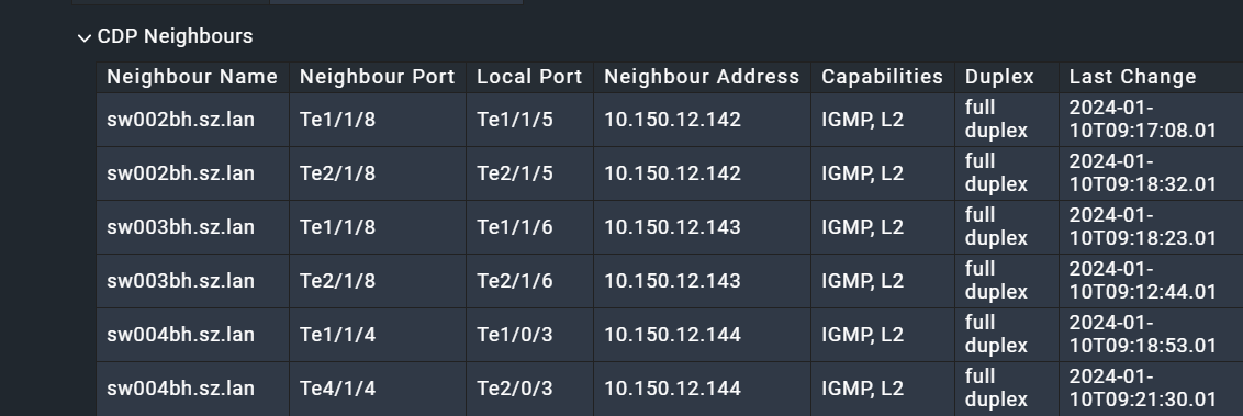

I have addtional question - we do have some site under Cisco prime management and it this case they have CDP Neighbours name in full domain format - see attached image (checkmk host are in short names only without domain). If i use HOST_MAP like below, result in error ? Should I use quotes then ? ( “sw001bh.sz.lan” = “sw001bh” )
[HOST_MAP]
sw001bh.sz.lan = “sw001bh”
Yes
Yes
No
NVDCT will automatically cut the domain name, except if you use the --keep-domain option. So as long as the hostname (without domain) matches the name in CMK you are fine.

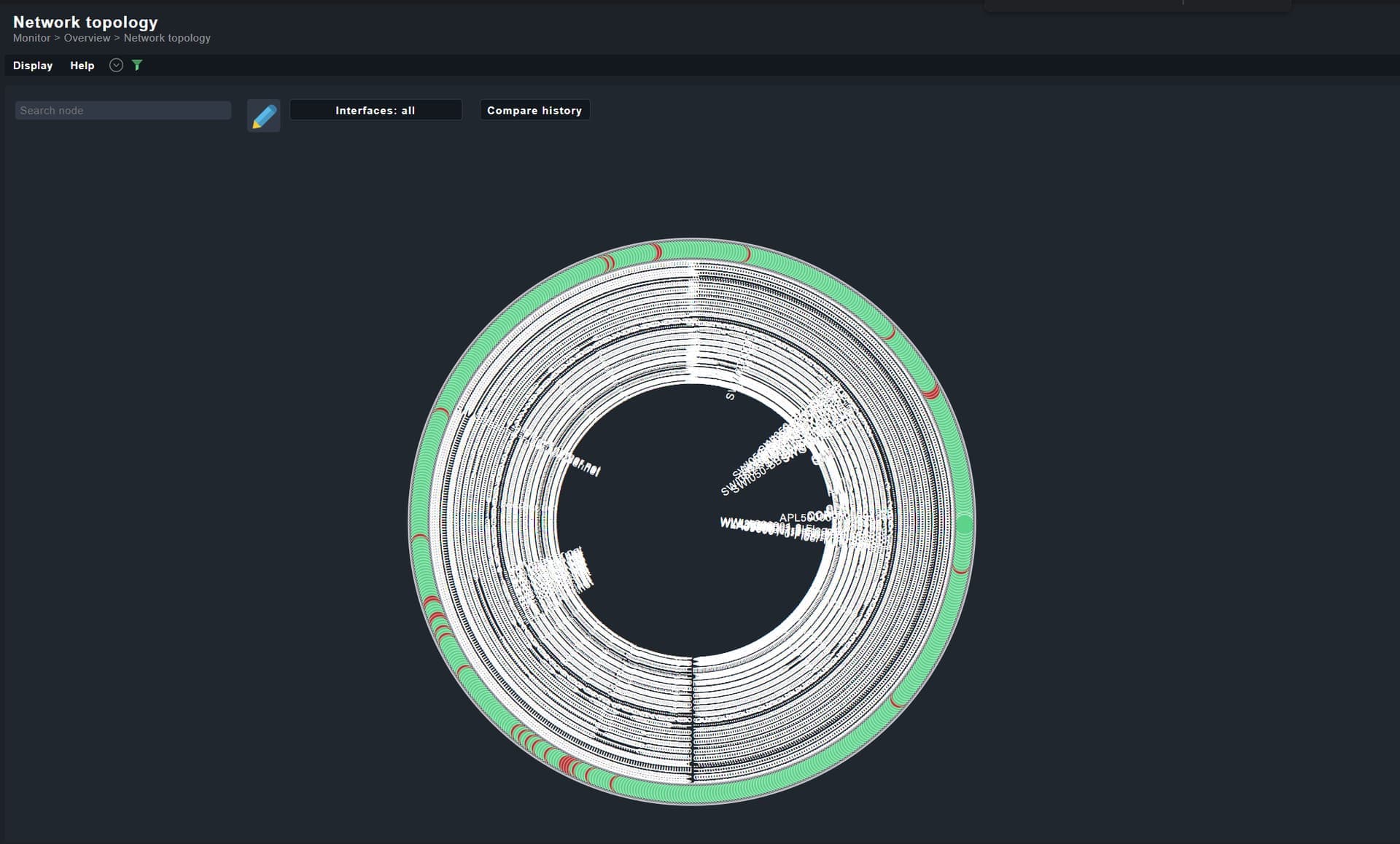

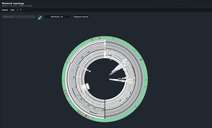

Hi, guys! Good afternoon.
My environment is pretty simple. I have mostly Fortinet devices connected in the following sequence:
Firewalls >> Switches >> APs
The Firewalls and Switches are LLDP capable and the information is shown in the WATO interface as result of the HW/SW Inventory.
I did created a NVDCT file using the FWs and SWs as seed devices to generate the topologies and this is what I’ve got:
There are no connections between the devices. The filters do not work as desired.
What should I do?

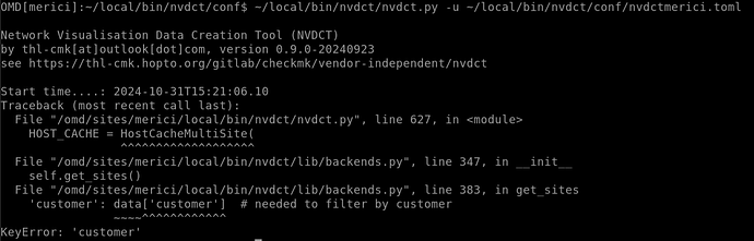

Hello guys,
I have followed the documentation and reached here with the error.
Can you shed some light, please?
Thanks.
Hi Suman,
this is something for @thl-cmk , as the error message is triggered in his mkp.
As a short info. I haven’t had much time in the last few months to make further progress on the entire visualization project. There are some ongoing major refactorings in our monitoring GUI framework that are taking up all of my time.
Hopefully over the winter holidays I can make some updates and integrate the latest feedback.
Regards
Andreas
I have the same issue. Tried adding --log-level DEBUG --log-to-stdout to the command but still get the same output on the screen but do get this in the log file.
2024-11-04 09:35:07,593 :: INFO :: nvdct :: () :: 609 :: Data creation started
2024-11-04 09:35:07,594 :: INFO :: settings :: sites() :: 544 :: fFound 0 to filter on
CME 2.3.0p19
Not sure if this is the best over all fix but I changed line 387 in /opt/omd/sites/SITENAME/local/bin/nvdct/lib/backends.py and this fixed the error and was able to finally get data into the Network Topology.
‘customer’: data[‘customer’] # needed to filter by customer
to
‘customer’: data.get(‘customer’), # needed to filter by customer
I think this change is correct as you have only the customer attribute if you use a MSP edition of CheckMK.
I can ping @thl-cmk that he can implement this in his package.
Cool. I can’t take credit for it as it came from a ChatGPT suggestion but what was confusing is that I do have the MSP version. From what I understand it was not getting any data from the ‘customer’ values. I am not a programmer so I defer to the developer(s) to make sure this is correct.
@rickb & @shresu this was already fixed internally (in the same way as ChatGPT suggested :wink: ), but didn’t make it onto my website. It is now online.
@rickb send you a PM.

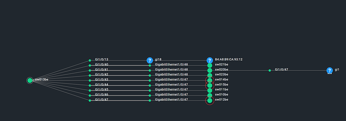

Hello @thl-cmk
Thanks for your Network Visualization Tool… thats great and our Network Team like it :wink:
But we have a probelm…
we have 3 Types of cisco switches…
  1. Switches where the CDP neighbor name is “normal” FQDN
  2. Switches where the CDP neighbor name is FQDN + Serial Number for example switch12.domain.de(fdo123456) but this can be changed via a setting to type 1
  3. Switches like type 2 but we are not able to change the behaviour. in this case your tool can’t match interfaces and we have only blue questionmarks :frowning:
is there an option to remove the “(fdo123456)” at the end of the device-name?
Thanks
