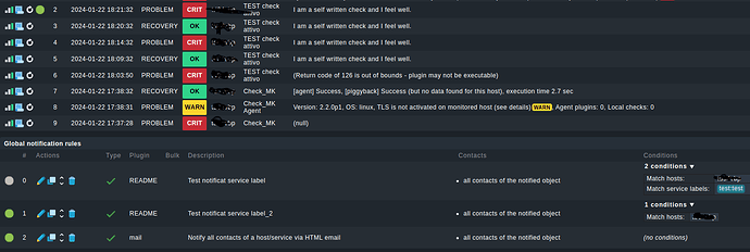

I have the same problem where notification based on service label did not match on 2.2.0p1 RAW edition.
I updated to last minor 2.2.0p19 but the problem persists.
After many tests I fount that notification did not match only on active checks while passive checks over check mk agent match and work correctly.

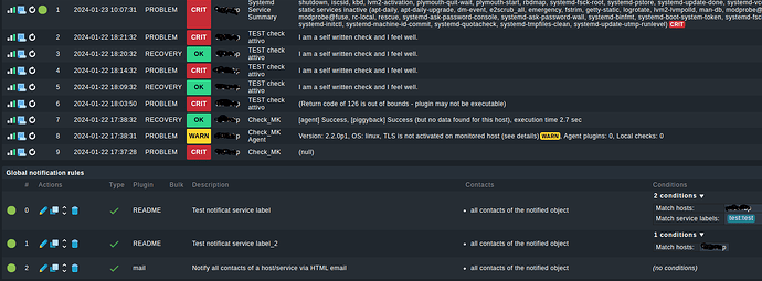

For testing purposes I made a clean installation of check MK RAW edition on new server debian 12 with Checkmk Raw Edition 2.2.0p19 and the problem persists. Only passive check match the notification with service label.
Passive check:
Active check:

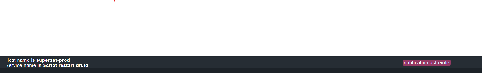

What is the service label and what’s within ~/var/log/notify.log about the rule not matching?
After many tests, the issue is still present.
As @a.ahmadzadeh initally describes, it’s working for some services and not some.
Example :
Working notification :
2025-05-12 11:49:04,837 [20] [cmk.base.notify] Got raw notification (superset-prod;Script restart druid) context with 54 variables
2025-05-12 11:49:04,842 [20] [cmk.base.notify] Global rule ‘Testing Astreinte’…
2025-05-12 11:49:04,842 [20] [cmk.base.notify] → matches!
2025-05-12 11:49:04,843 [20] [cmk.base.notify] - adding notification of cmkadmin via msteams
