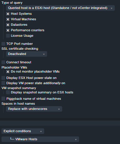

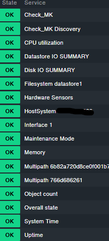

I built a new ubuntu 22 server VM and started with 2.4 raw and a completely clean config. 1x esxi 6 server, 1x esxi 8 server, and the vmware special agent rule applied to those explicit hosts. I have the vmware “type of query” set correctly for a single esxi host. The esxi 6 fails with the same SSL error as expected, and interesting, the esxi 8 does not fail, but is missing most of the actual important metrics on a service discovery.
what the server shows on raw 2.3p30
what the server shows on raw 2.4 with exactly the same settings
