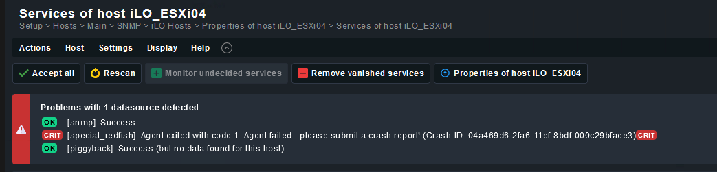

So I added one more ILO, and it immediately started crashing. It didn’t crash at all overnight with just a single host, but adding a second it started crashing.

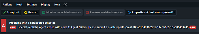

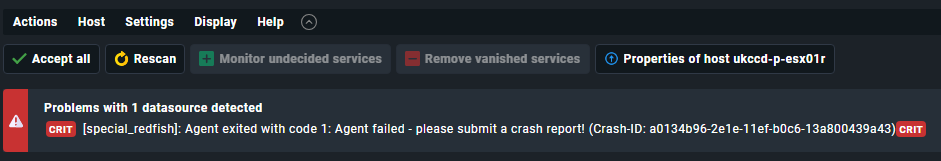

I removed all hosts, and re-added the original host that seemed fine overnight, and during initial service discovery this happened:
A rescan worked fine though, but it now keeps crashing as it did before. I am so lost!

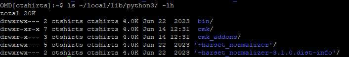

First step i would inspect the folder “~/local/lib/python3/”
What’s there inside?
Folder contents:
This is not an upgraded site from 2.2 where redfish plugin was working before or?
Normally there are way more libs installed.
If it is a clean installation for 2.3 then i don’t know where the “normalizer” comes from. Looks strange.
I did go in and remove a LOT of python packages, since the upgrade failed multiple times until I did this. I did not know where most of these came from either.
I did take a dump of the original contents of the python plugins before I eviscerated them:

The normalizer plugin got uninstalled, but left some weird folder names there as you see “~harset_normalizer”. I tried removing it but it wouldnt! Wouldnt be causing a problem would it do you think?

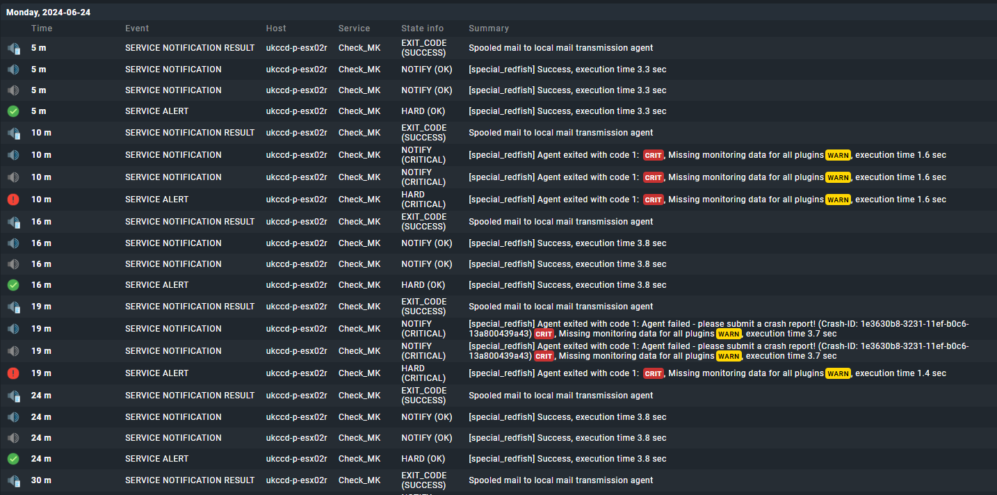

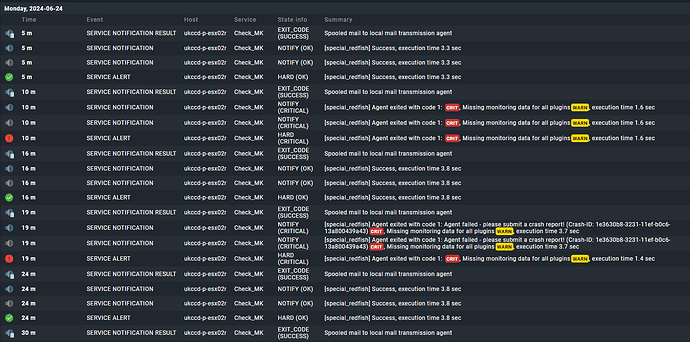

The alert history for the problematic ILO reveals some interesting timings - it seems to be triggering alerts almost exactly every 5 minutes:
