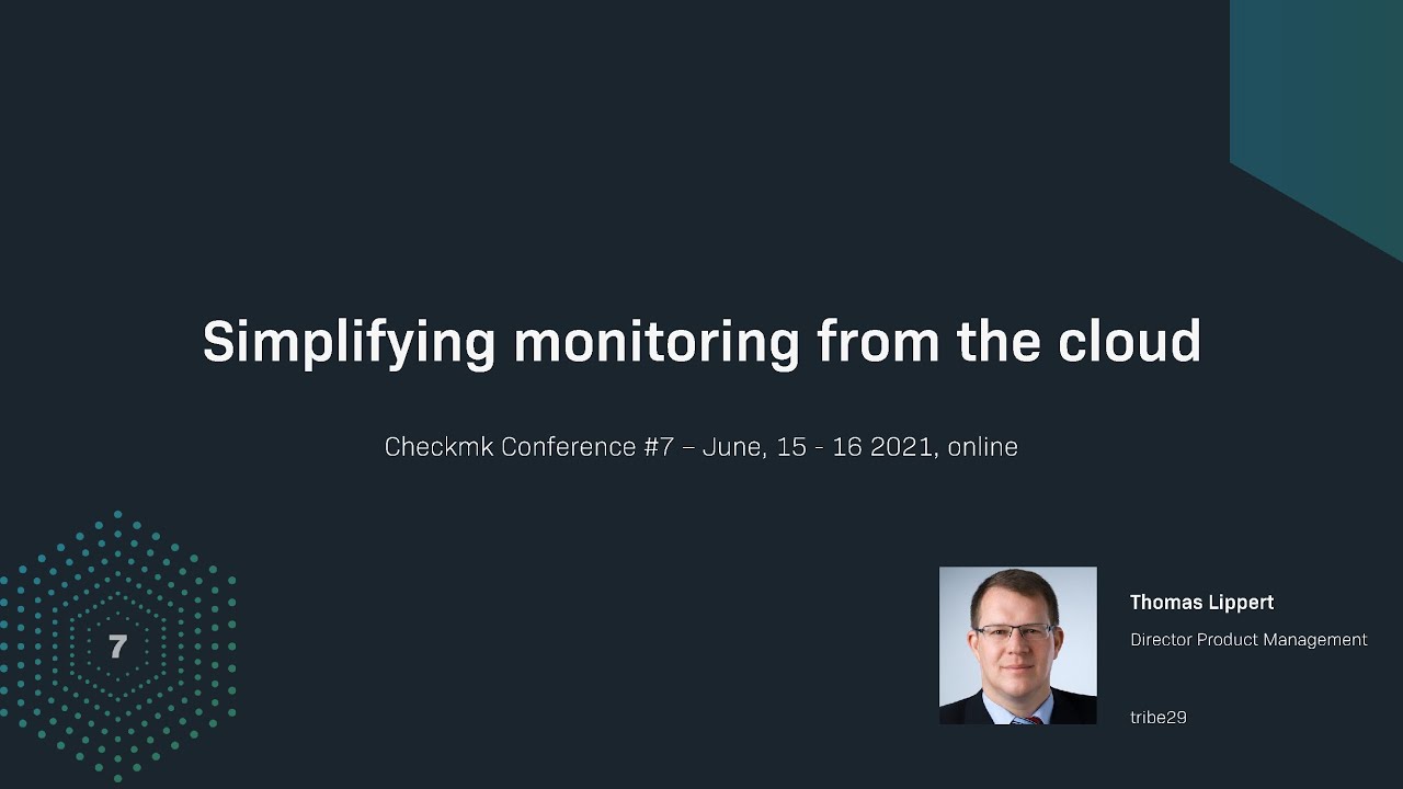

So in last years conference when Tribe talked about cloud monitoring they specifically mentioned that you could setup a local server to act as a proxy for SNMP and that the proxy would use push mode to a central site.
In this years conference there were zero talk about that, so perhaps that feature was scrapped but would have helped you.

I found the link. This was discussed in 2021 conference as local SNMP proxy (Checkmk light) - This was a cloud example but could be used in isolated environments as well.
Yep!
We need to build something for Checkmk SaaS. What it will be exactly (e.g. local proxy for special agent and SNMP monitoring) is still to be decided.
