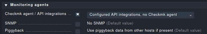

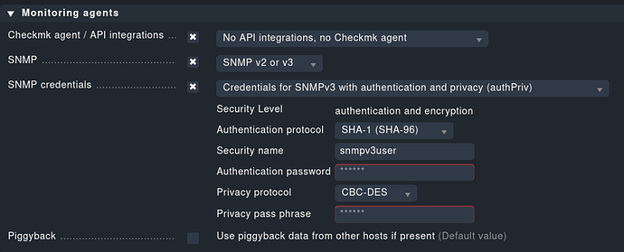

On check_mk, I try 2 things:

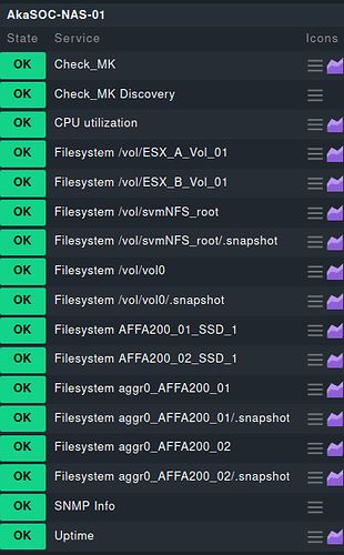

And… That works good, but I have only 17 Services:
I remember on other Netapp where I have near 70 or 80 services.
So why only this service ? I have lot of more result with SNMWALK.

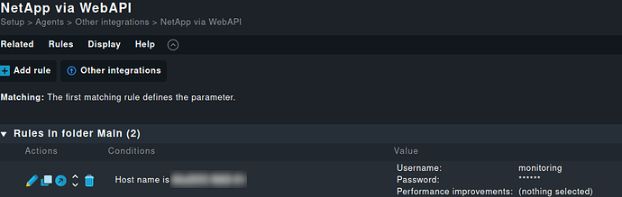

I Try API with user monitoring:
So with that I Try to had API User option:
checkmk_bug_08
But I have this error:

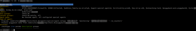

With SNMPv3, when I do the cmk -D nas, I see that:
If I try with only API :
Check_mk see 0 service.
Thank you.
What happens if you execute the command shown at → Type of agent: → Program: ?
