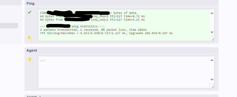

Also on this server when we re-scan there should be 900 services it brings back but it’s only finding 63 services and 53 disabled ones. Any idea what might be causing that?
A similar SQL server is showing 800 services but this one isn’t bringing anywhere near this amount. When I go into test connection the agent one is just spinning
