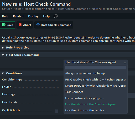

that worked with a simple SSH config I was able to establish a connection. Now the checks work and the server is also on the correct site. Unfortunately, of course, the PING does not work and therefore the server is displayed as DOWN, even if all checks work. Do you know a solution for this?
For this purpose the rule “Host Check Command” exists.
Usually the host state is determined by some version of PING. If that is not possible you can either set it to “always up” or to the status of some service (and other things).
In our environment we use the status of the Checkmk Agent. If that is green, the host is considered UP. In every other case the host is considered DOWN.
Thank you Dirk! That worked.
