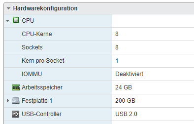

top - 12:24:04 up 3 days, 5:03, 1 user, load average: 46.71, 44.69, 30.80
Tasks: 441 total, 111 running, 330 sleeping, 0 stopped, 0 zombie
%Cpu(s): 90.9 us, 9.1 sy, 0.0 ni, 0.0 id, 0.0 wa, 0.0 hi, 0.0 si, 0.0 st
MiB Mem : 24105.7 total, 5430.2 free, 9589.1 used, 9086.3 buff/cache
MiB Swap: 8188.0 total, 7771.7 free, 416.2 used. 10767.1 avail Mem
How many cores has your machine?
A load between 30 and 47 is really demanding for the system.

Hi @andreas-doehler ,
you was rigth with the load of the cpu
i`d have create a new site on a second server and transfered around 1k host to the new distributed site.
Now it`s working again, not so fast as expected but it works !!!
5K Hosts on Site1 with ~30K Services
1K Hosts on Site2 with ~10K Services
