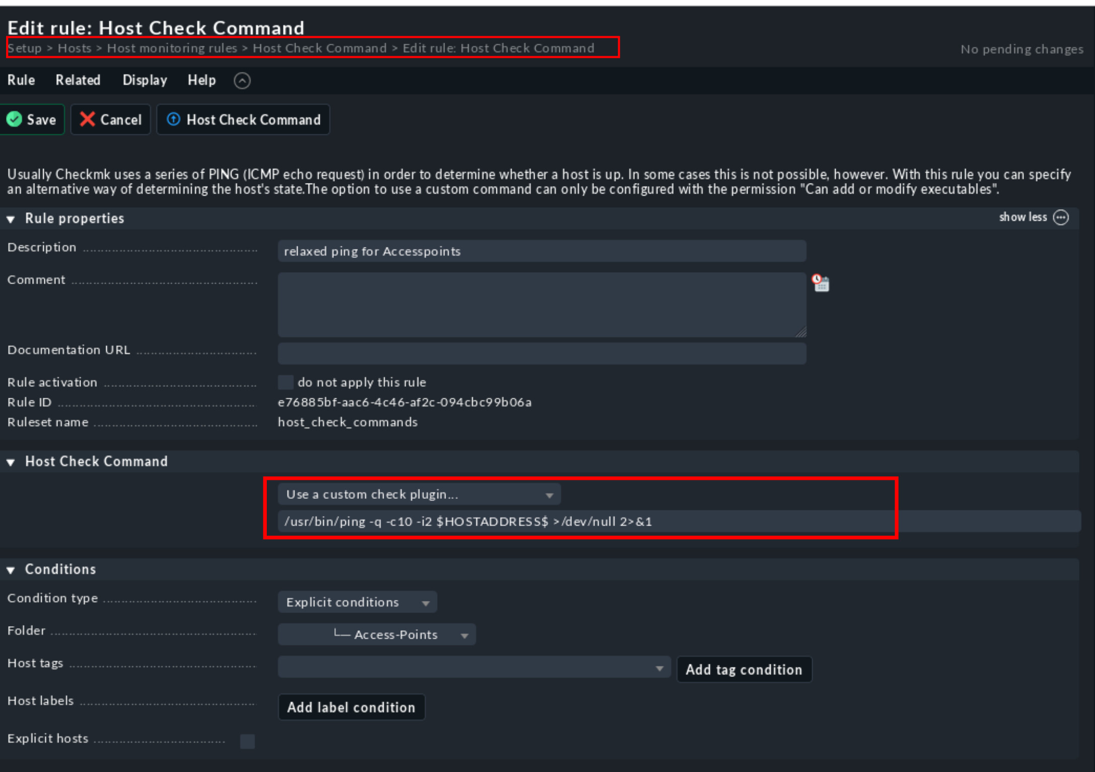

at different locations I had the issue with some accesspoints that sometimes got ping timeouts. That seemed pretty normal, so I just do not want that to be visible in the webinterface for those devices.
To make ping check a bit more relaxed for those specific hosts, I configured the following host_check_command for those devices:
/usr/bin/ping -q -c10 -i2 $HOSTADDRESS$ >/dev/null 2>&1
Explanation: Do 10 ping checks with wait time of 2 seconds after each ping and if one of them is ok, the host is ok.

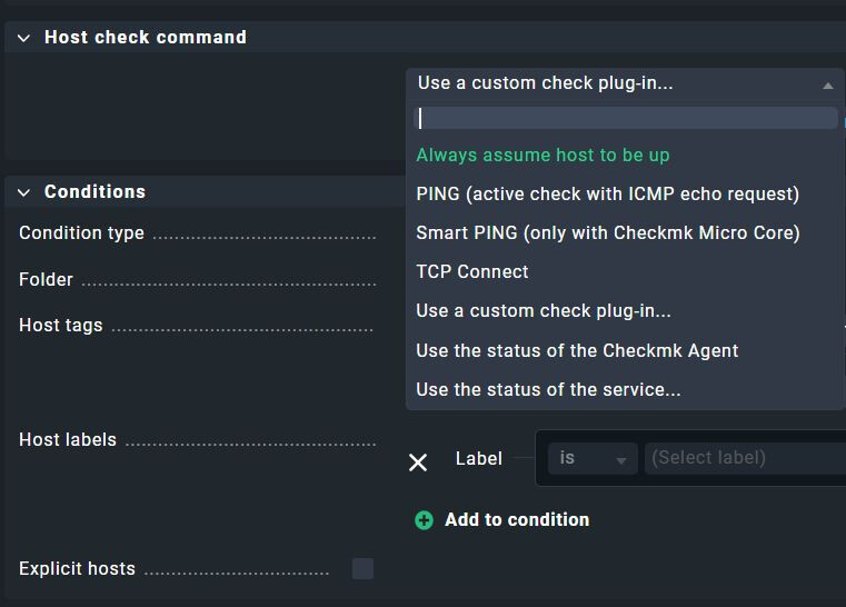

Dear @XJack
I’ve the same issue… I really need a workaround to lots of false positives…
Where do I put that command?
Thanks a lot
Ok then, I did right!
I’ll let you know, thanks a lot!
Well… it seems working… let’s wait for another couple days, in the meantime thanks!
