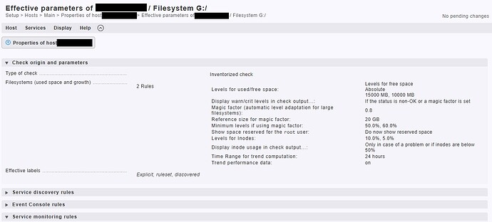

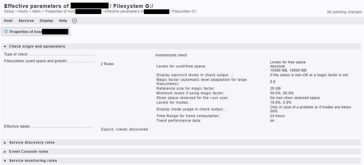

Hello Bernd,
thank you for your answer.
I am pretty sure, that I have already ruled out your proposal 1 with the higher priority rule. I have 2 rules for “filesystem” - a global rule which goes by percentages and includes ALL hosts. And second rule which filters on a certain host with a certain service (mountpoint name) and goes with fixed values (MB). The second rule is is in position 0 and the first is in position 1. When I disable the fixed value rule, the output of the check goes back to percentage. So I am 99% sure, that I have the correct rule
As for your proposal 2 - I am not sure that I can follow you. I have looked up the “Effective parameters” and the look fine to me. But I am not sure, what is ment with “green match icon”.
I will add a screenshot verify

Hi David,
this looks like a known interaction between the Magic Factor and absolute free space levels in Checkmk 2.2.
Even though your specific rule (position 0) is correctly matched in “Effective Parameters”, the Magic Factor configured in your global rule (position 1) can still interfere — because sub-parameters from multiple rules are merged. When the Magic Factor is active, it can override the absolute levels with its own levels_low fallback values.
Two things to try:
  1. In your specific rule (position 0): Explicitly set the Magic Factor to 1.0 (= no scaling) and make sure “Minimum levels if using magic factor” is either disabled or set to non-critical values.
  2. In your global rule (position 1): Make sure the Magic Factor checkbox is not applying to the host/mountpoint already covered by your specific rule — or disable it there entirely.
This exact bug (absolute free space levels ignored when Magic Factor = 1.0) was fixed in Werk #15908, released with 2.2.0p8. Since you’re on 2.2.0p47 the fix should be present, so the issue is most likely the sub-parameter merging between your two rules.

Dear @BH2005
YOU ARE THE GOAT !!!
Your tipp with the merging rules was spot-on! Never in a million years would I have come up with that idea.
Filesystem check now works like a charm - thank you again and again!!!
Regards
