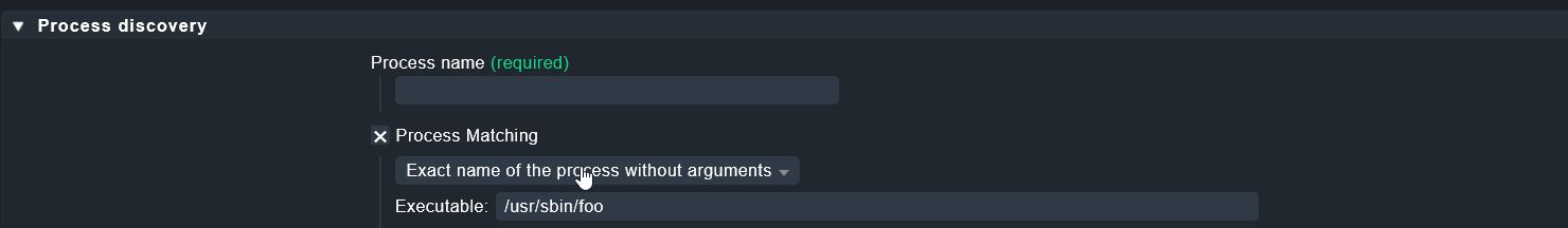

Can you share your process discovery rule? that sounds like you just gave a service name but no filter for the process, hence all processes match:
the “Process matching” option is often overlooked.
Im not sure what to but in the process matching I have tried differnt things like name of the application and directory name c:.…\fil.exe. What should i but in for a regular exe file thats running?
