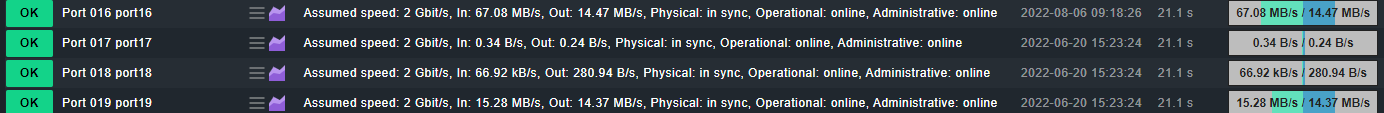

All ports are “Assumed speed: 2 Gbit/s” but inventory shows right speed
Inventory
Discovered services
Is this bug or did I do something wrong ?
