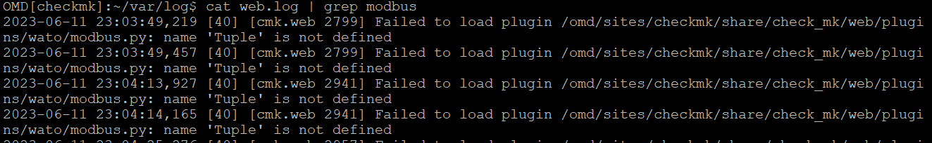

It might not work and I`m evaluating that on a test environment. :thinking:
The steps are correct, but using 2.2.0 version it does not work properly. You can check the log file and you might see that:
Using 2.1 or a previous one will work:
Don`t forget to intall libmodbus-dev and libmodbus-5.

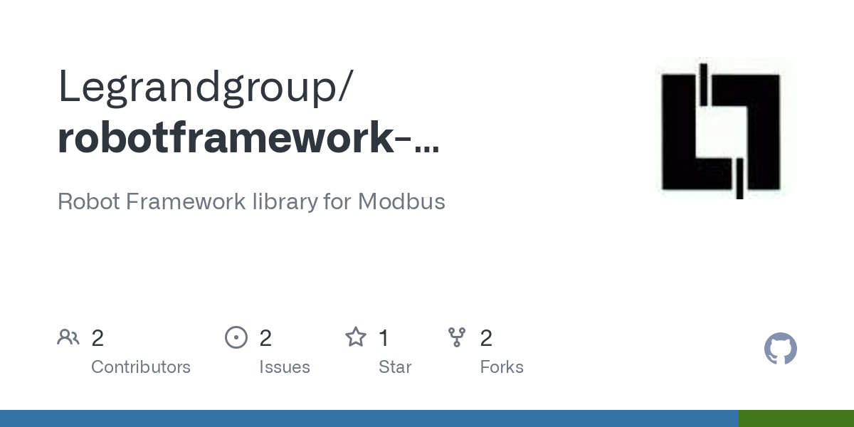

@stef In that case it seems that we are dealing with an exception, we could use a different plugin like those ones:
If you have any application that can connect to your devices and somehow export that data we can make Checkmk read data and process it. The other alternative is to use RobotMK to use your application and export it like a Robot.
Perhaps
is of any help?
