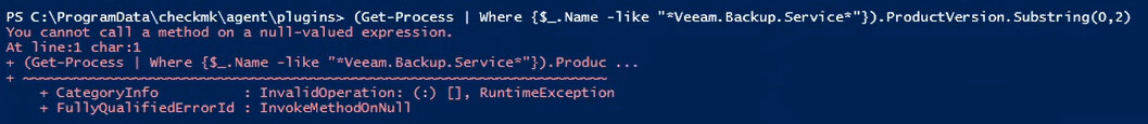

This line
[int](Get-Process | Where {$_.Name -like "*Veeam.Backup.Service*"}).ProductVersion.Substring(0,2)
does not deliver a proper result and the script always assumes Version 13.

Our output for Veeam 12:

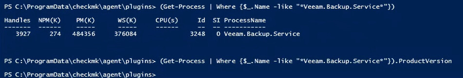

.ProductVersion has no result for the process. The first try/catch-block will fail and 13 is set as version.
The .Substring method fails:
That is more than curious:
We monitor 55 Veeam servers, of those a very small number is 13, an even smaller number is still 11, and the vast majority is 12 (12.3.1.1139 & 12.3.2.3617, to be precise). This modified script runs on all of them, and if it didn’t work on them I would certainly have seen it in tons of unknown/vanished services. Granted, I haven’t run the PowerShell Get-Process
 .ProductVersion on all of them, but still. I’m rather confused about your system’s behavior & have no good idea what’s going on.
Is it possible that your agent is not running as Local System?
If i do the Powershell line in a shell without admin rights i get also an empty output.
With a proper admin shell the version is reported correctly.
The ProductVersion property should be available for nearly all processes. The check_mk_agent process should report the installed agent version.
Admin privs do seem to make a difference for me, too. Without them .ProductVersion is empty/undefined/whatever, with them they’re present. My agents are all running as Local System, therefore I don’t see the problems that Stefan sees.

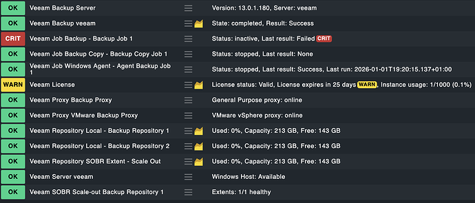

IÂŽve started with a new implementation of a REST based monitoring plugin. As i only have a small test environment without integration in other solutions like vsphere, cloud or s3 it is only tested in the very basic parts.
This is in active development, only use if you want to test or participate in the development process.
Current Features :
  • Jobs - Backup/replication job status, last result, schedule
  • Tasks - Per-VM/object backup details with performance metrics
  • Repositories - Capacity, usage levels, online status
  • Proxies - Online/disabled/outdated status
  • Managed Servers - vCenter, ESXi, Hyper-V host availability
  • License - Status, expiration, instance usage
  • Scale-Out Repositories - Extent health, tier status
  • WAN Accelerators - Cache size, configuration
If you have ideas, feature requests or enhancements, hit me up here in the forum chat.
