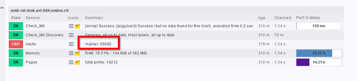

How can I do a Service State Translate based on the Summary instead of the Service Name?
For Example, i have some printers and they give the summary “marker: xy” back - i will ignore these States, but i want the real errors:

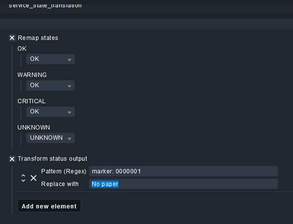

What is your desired output? Do you have a lookup table what “marker: number” means and want to show it directly in service output?
You can rewrite the output of the summary with the [Service state translation]:
